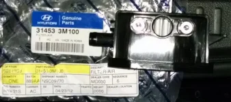

Can someone post the Hyundai part number for the fuel tank air filter? Thanks!
Try this pic on found:) Part number shows on filte bag.
EDIT - Something is jacked up, because I checked the pic earlier and I was able to expand/enhance, but now I can't.
The part number should be 31453 3M100, but just in case I'm wrong i'd feel better to post the pic larger this time.
OK - Just confirmed with the sites below, but they show for the 4.6L, I'm not sure if this works with the 3.8L???? They probably use the same filter, but I would confirm from the store you purchase from 1st to ensure.

I cant expand the pic. Maybe just post the part number?
Thanks! I found it in the 3.8L Sedan section. Same part number: 31453-3M100
