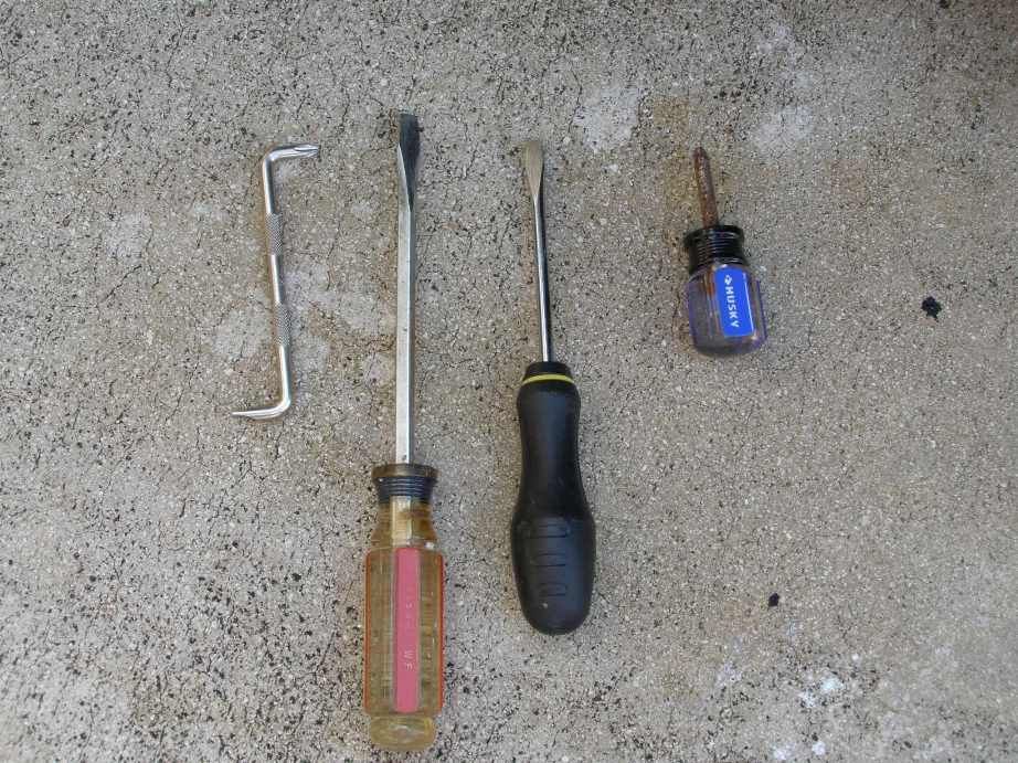

Tools required:

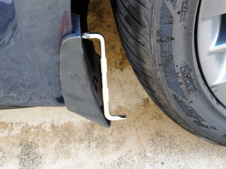

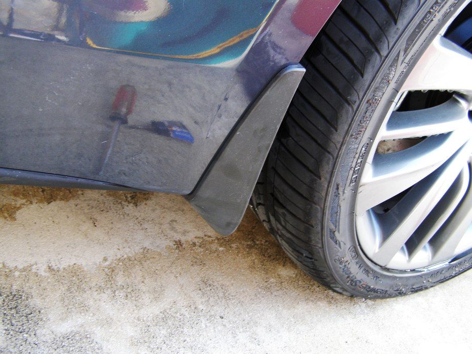

First clean the area and dry it before installing on the Mud Guards.
There are only three screws on the rear install. Two visible and one on the bottom. Remove these two screws as shown below.

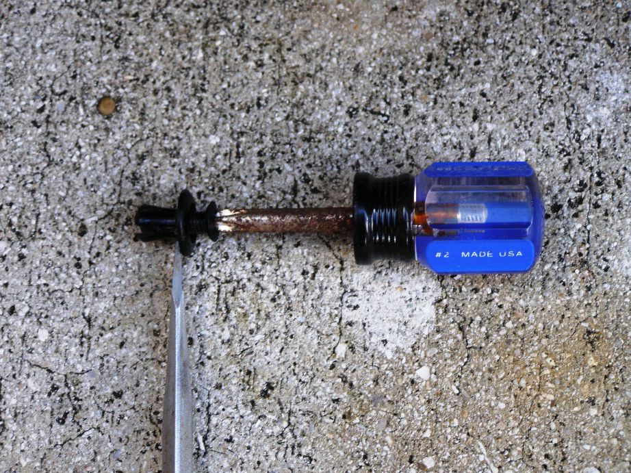

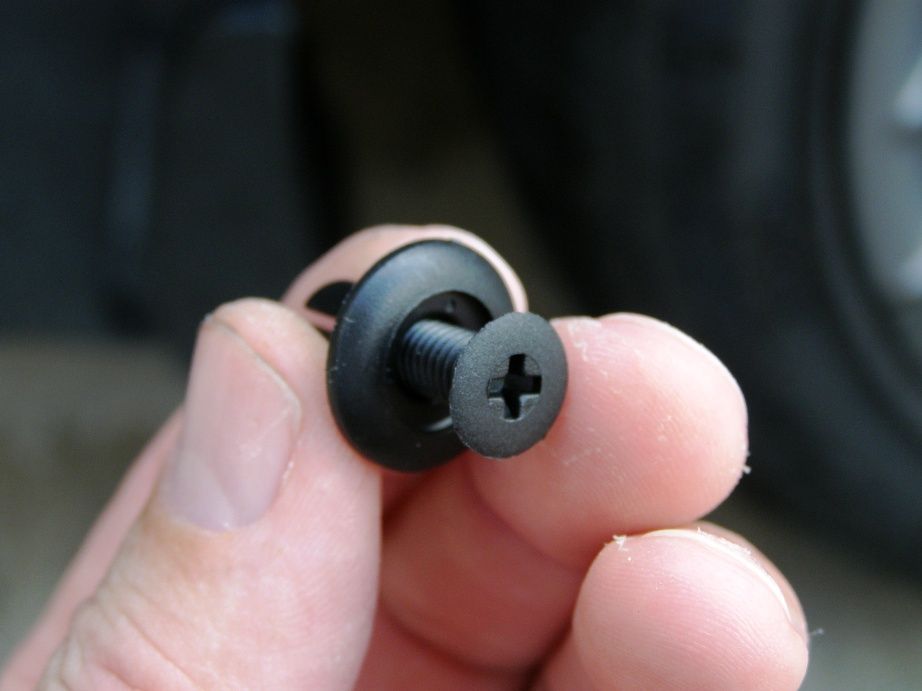

This is the screw located on the bottom.
Use a screw driver as shown below underneath the plastic screw cap then install a screwdriver to unscrew it. Once it gets far enough out you can just remove it with your fingers.
Discard all hardware removed from car and use the new hardware that came with the mud guards.

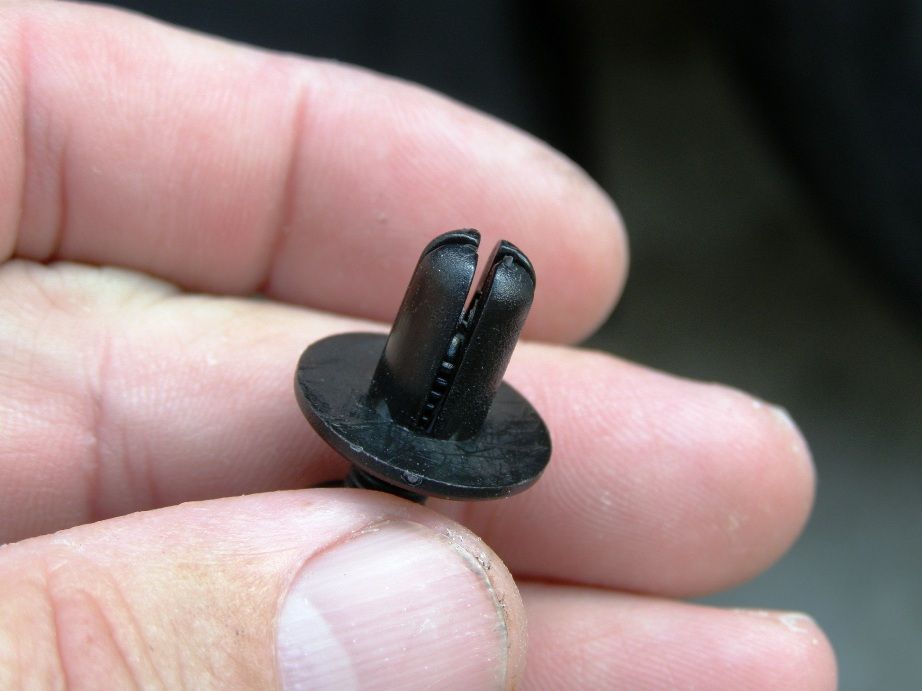

Install new plastic cap & screw through large hole in bottom of mud guard.
Place mud guard on car and press this cap & screw into the existing hole in car. You will feel it snap into place. No screwing it required.

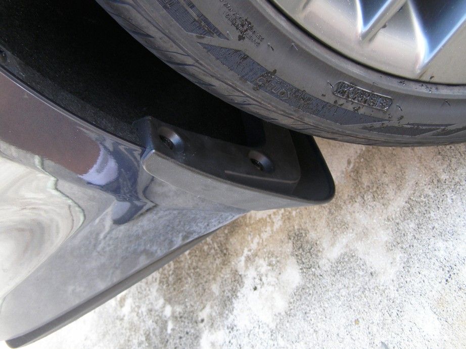

Now install two screws as shown below.
Finished rear install

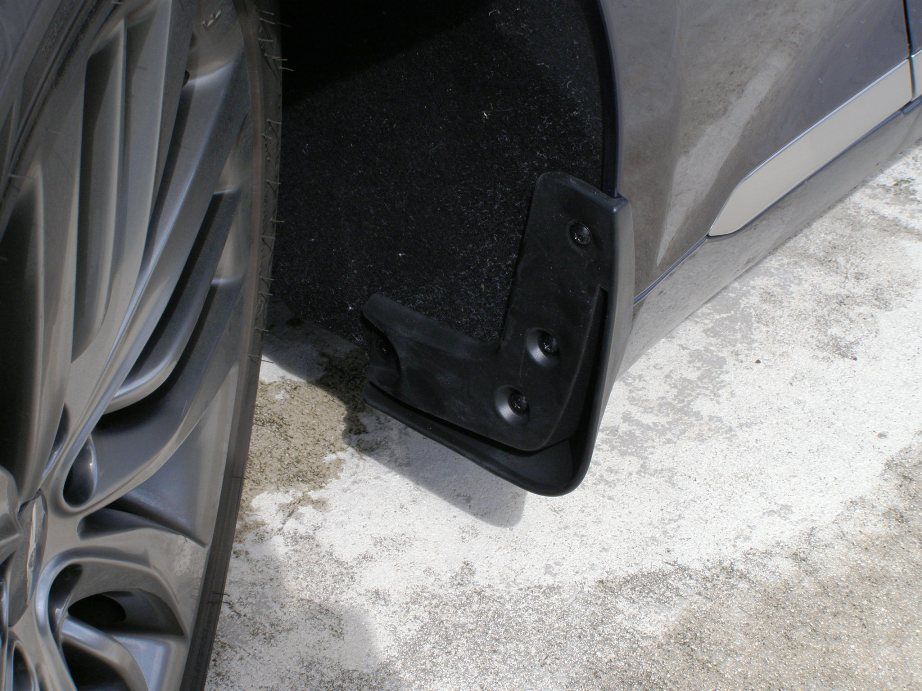

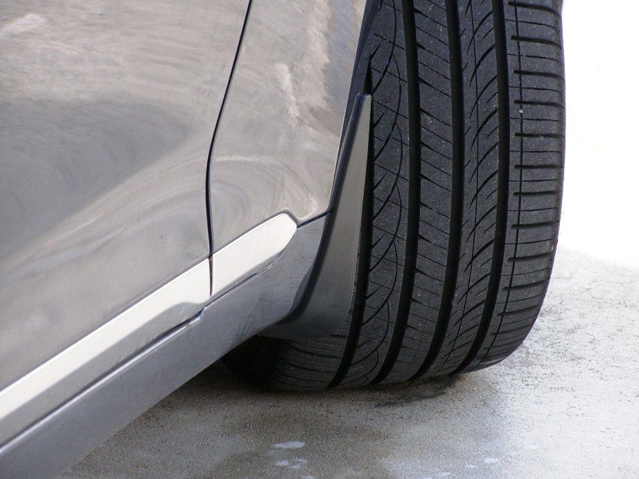

Front mud guard install:

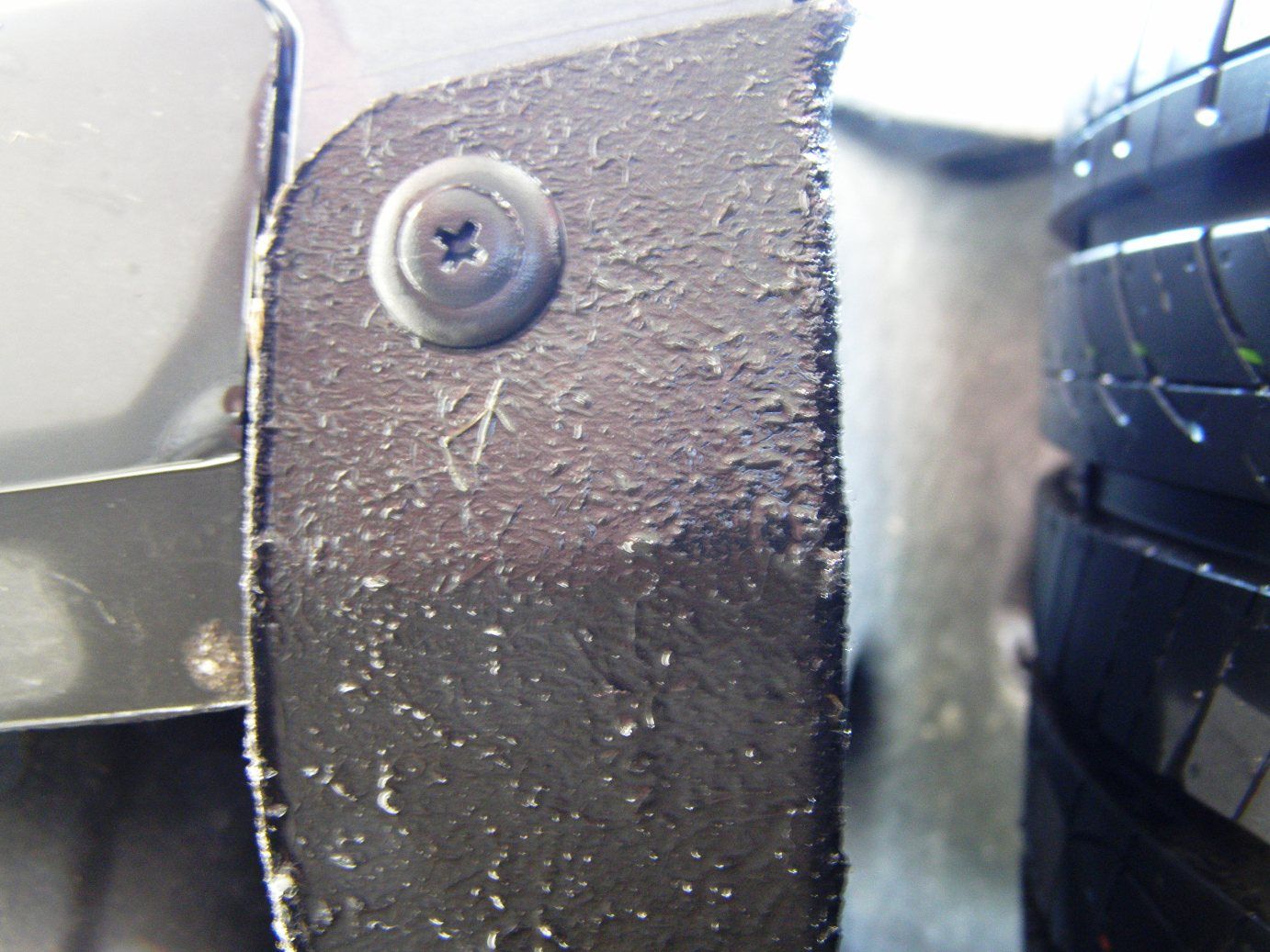

There are 4 screws on the side and one on the bottom to install. Note that on my car there was no screw on the bottom to remove but the hole is there already.
Turn the wheel to gain access and remove and install as noted above for the rear. Turn the wheel in the other direction to install the other side.
