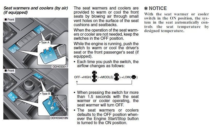

The manual calls them Seat Warmers & Coolers. My guess is that they are run by the AC system blowing cold air, not just cabin air. I agree with what was stated above, they will freeze your buns for sure.
That explains a lot. The 3 way switch controls the seat fan not the temperature! Mine's not blowing through the seat very well (or at all) and instead is ventilating a frozen seat frame into the foot well. Thank you for your post! I need to RFM.
