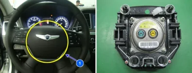

Here a quick rundown
update: Don't change the harness. See post #14 (this is #12) by scrolling down...
There's 3 access holes you have to press to get the airbag loose. The first one is under the steering wheel - it's like 3mm wide. Put a screw driver into the hole and push in. You'll see the airbag pop out from that corner. Turn the steering wheel counterclockwise until the paddle shifter is right in the middle. There's a bunch of holes behind the steering wheel - the big rectangular one - the second one from the top - push all the way then press down until you see the clips snap off. Turn the steering wheel clockwise until the other paddle shifter is in the middle and do the same on that side.
Pull the airbag.
Disconnect the car battery. Just unplug the negative.
Disconnect the airbag.
Pull up the orange top and then the plugs.
Remove all other harnesses.
Remove the steering wheel. There's five screws plus the lock bolt you need to take off. Now remove the steering wheel column (cover), unscrew the bottom screw then the top part of the cover comes off by pulling it apart. Pull the the cover apart. Now once you do that the bottom cover has two screws that need to come out. Now you you see the clock spring (it has yellow going around it) and the stalk. The clock spring and the stalk are connected by clips. There's four of them. Unclip. Replace the stalk.
Reconnect every thing back up the same way.
Reconnect the battery.
