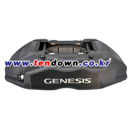

Don't forget about the Dynamic Edition Front Calipers that say Genesis... Some info in this thread Brake Modifications mainly provided by none other than our resident expert 84FordMan
There is also a page on bmmotors that shows the stock brakes compared to the Dynamic Edition but I can't find the direct link at the moment.
The Dynamic Edition calipers are the same ones as the 2013+ Equus, just minus the branding on the front. They are a monoblock 4 piston caliper made by Mando. You also get the Equus 14.2" rotors. I have a set of these calipers in my shed, they did not clear the Coupe 18s even with a 20mm spacer, require at least 19s to fit.
The brand whore in me would need the ones pictured. :p
Looked into getting them but don't have enough backspacing to run them on my Infinitewerks. Put together a comparison chart comparing the dynamic edition/equus and coupe brembos to the OEM calipers, I can send it over if you like. Need more backspacing for the dynamic/equus caliper.
