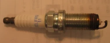

At www.hmaservice.com it says the plugs are NGK ILRF5B-11 (I think they meant ILFR5B-11). The plugs I pulled out tonight are NGK DILFR5E-11 (attached photo) but I can't find that part number anywhere on the net. The closest I find is an IFR5E-11, which runs about $12, but the reach for those plugs is too short (19mm). The reach on the DILFR5E-11 is 25mm.

Note in the photo of the plug, that the end of the plug is much darker than the rest of the plug. In the 3 valve Ford 4.7 engines, it is in this area that carbon builds up, causing the plug to lock into place, and breaking when you try to remove it. As I said in another thread, Ford has you fill the plug cavity with carb cleaner and let it sit for a few hours, or overnight, before you try to remove the plug, as they had many plugs break trying to remove them.
I also notice that the plug in the photo has two iridium (sp) tips. One on the center electrode and one on the tip of the side electrode. These plugs should last well past 100,000 miles. In past cars, I always changed plugs using Double Platinum Tip Plugs, and they always lasted over 100,000 miles.
