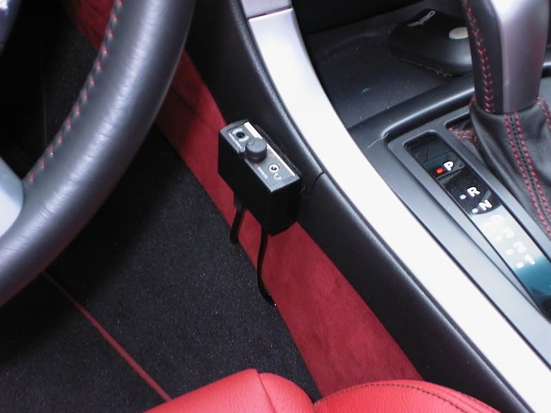

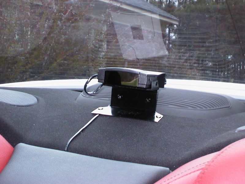

I've got the Valentine in my GTO and love it. The directional alert arrows are something that I couldn't live without now. My installation is somewhat different, so I have included some pictures.
The main unit is mounted on the package shelf in the rear window. I fabricated a DIY bracket from some corner braces I bought at Lowes. The forward line of sight shoots between the front seats and no degradation of performance has occurred.
The remote control box (an optional purchase) is mounted to the side of the console with industrial strength Velcro.
The remote alert display (another optional purchase) is mounted on top of the steering column...also with Velcro.
All connecting wiring is hidden so the installation is a clean one. Power is supplied from a hard wire connection to an ignition switched fuse in the fuse box under the dash. The rear mounted main unit is very stealthy and is not noticeable unless you know where to look for it.

Very creative, Gentau. Not having the main unit hanging off the windshield has some appeal (occasionally, the car wash guys will bump it, dislodging the suction cups, etc.), so perhaps I should look into the remote display. I assume the "remote control box" is necessary to feed data to the remote display (and are purchased together)?

Gentau, Thanks for the photos. The mount is excellent, not seen this before. I have had my concealed display in the same place on the steering wheel column before. How have you attached it to the steering column. (Just some what hesitant in using adhesive tape, as previously, on my new Genesis !). I like where you have munted the remote controller too.
Musher51, you do not have to buy both remote units. Valentine allows you to use either the remote volume control, or the remote screen, or both. The remote screen comes with a mute button too. I have only the concealed dispay connected to the main unit. Thanks for your previous comments too. I have not fitted my Valentine unit to the Genesis yet, but will certainly follow your hints for getting behind the door pillar and fuse box. Thanks again.
Matt,
The remote display is, indeed, secured to the steering column with adhesive backed Velcro. I wasn't crazy about the idea; but it was better than the alternative of drilling holes somewhere.
Musher,
If you mount the main unit within arms reach, you will not need both remote pieces. As Matt said, the remote display has a mute switch. However, it does not have an on/off switch or volume control (those are on the main unit). Since I cannot reach the main unit from the drivers seat, I purchased the remote control box that is mounted on the center console. It does have an on/off switch with volume control that overrides the normal controls on the main unit.
In the event that I should get stopped, I can simply turn the entire system off from the remote control on the console. Then, when John Law stands by my window, there will be no light display or sound to draw his attention to the detector.
