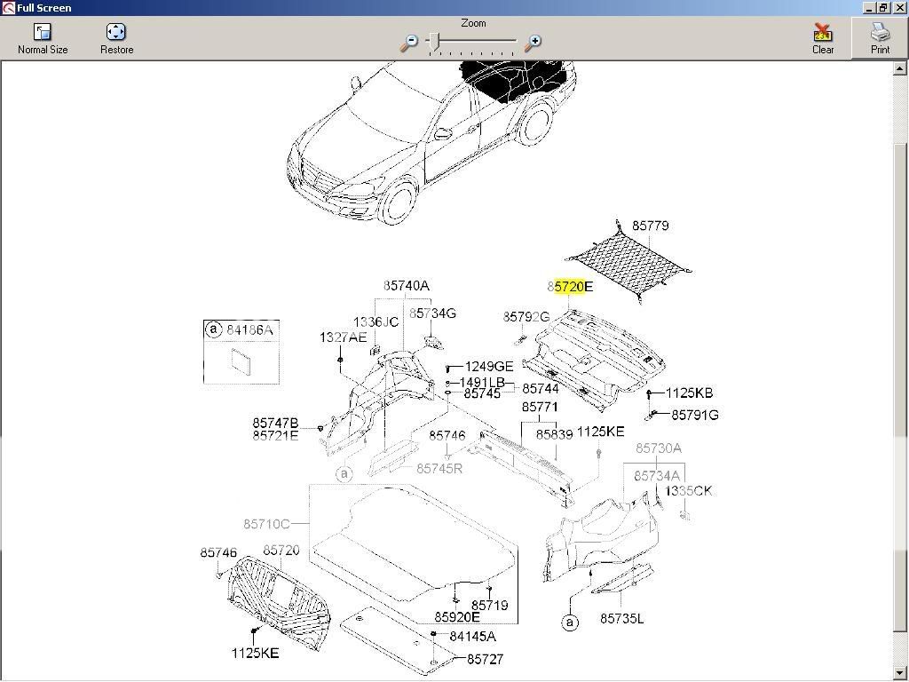

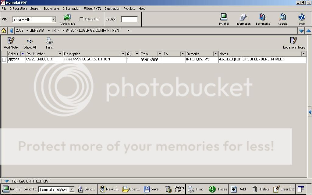

I checked our V8 and it has a cover, too. I was going to pull it down and see if there was a part number in it, but it appears to be pop-riveted to the metal rear shelf. :confused: So, I checked the parts catalog. The part number seems to be 85720-3M000-BR. Retails for $143.23. Per the catalog, it is specific to the 4.6. Here are the parts catalog screenshots:
It's # 85720E:
Parts detail:
Great info, EVH...thanks! The $64K question is "will the trim assembly fit into a V6 trunk"? It seems unlikely that there are dimensional differences between the two, but if the liner can be retrofitted onto 3.8Ls, I expect HMA will see a flurry of orders for this part by current owners.

The assembly "should" fit. The part number for the side trim panels and the trim panel on the back side of the rear seat are the same for the V6/V8, so in theory, the space where the new carpeted panel goes is the same as the empty space on the V6 models. The only issue I see right now is that the panel is riveted in place, as near as I can tell and is not easily removable nor easy to install without drilling and using a rivet-gun.
