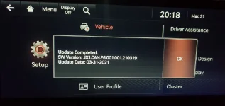

A new software update is available for GV80 and G80(2021). Map version looks to be the same with the one car came with, as well as the firmware.canada.webpUSA.webp
I did the update for my GV80, took approx. 45 min to update.
No new features(at least for Canada), the only difference is in responsiveness of the infotainment system and the sound system seems to better (might be my impression). The voice recognition looks to be improved, now can set the address as destination for the navigation system. Previously was intermittent, sometimes could not set. This is all I checked so far. Maybe are other improvements as well.
A new software update is available for GV80 and G80(2021). Map version looks to be the same with the one car came with, as well as the firmware.View attachment 35477View attachment 35478

Got the ~17GB file saved to a USB stick. But when I started the upload in my GV80 it stuck at 0% for more than 10 mins straight (see attached).
Removed the USB and tried two more times but got the same result, so I gave up. Hope you have more luck tomorrow!

It is not stuck. It's taking long to see the progress. I forgot to mention....
Looking at the downloaded files majority are archives. Looks like the system decompress them once the installation starts.
