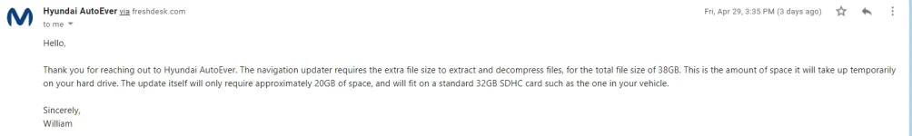

Anyone experiencing issues downloading the update to the SD card? I am using my existing SD card which is about 29GB but says this update requires an SD card with a recommended 38GB.
I think this statement needs some clarification. Based on your post I bought a 64GB card before starting the download/update.
The update tool says you need 38GB hard drive space. It does not state that you need an SD card that size. I suspect you were trying to download the files directly to the card.
The correct procedure is to download the files to your computer. Once that step is complete you'll be prompted to install the SD card and the tool will transfer the files onto the card.
Back to the 64GB card. This cannot be used. The tool states that FAT32 formatting must be used but cards larger than 32GB cannot be formatted in FAT32. You must use a 32GB card.

Thanks for your response. I have been downloading the updates directly to the SD and it has worked until now. I did reach out to tech support and they said what you are mentioning which is to download first to a computer then to the card. I was able to download and install the update over the weekend. This was their response to my question: 1651502152171.webp
