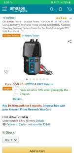

The last time I went to O'Reilly's they made me take my battery out and bring it inside and I had to wait a good 4 hours for their "test" to be conducted only to tell me that my battery was dead.
I just ordered a load tester for the battery off Amazon to test it myself because I also have little trust in people telling me what's wrong with my car without being able to see them conduct the work.
Heres a screenshot the load tester I purchased. It should be here tommorow.
You went to a f**ked off oreillys lol I'd never go there again. Oreillys I went to used a load tester and the test took all of 2 minutes.
