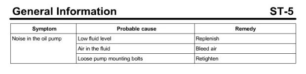

From the 2009 4.6 manual:
Bleed procedure:
More threads here:
