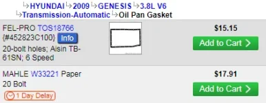

Where did you buy the filter and gasket? What oil did you use? Did you go to the dealer or on-line?
I saw on Rockauto the following:
Gasket
18194
Oil
18195
But I couldn't locate the filter. Are these good prices. Anyone's input would be appreciated.
