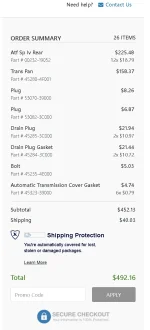

You need 10 and 14 mm hex socket for undoing underbody panel. NHTSA PDF says transmission fill/drain/level plugs are all 8 mm hex so get an allen key for that. If you have a scan tool that would be good to measure trans temp while doing it, torque wrench, trans fluid (I would get minimum 11 U.S. Qts), pump for trans fluid
Parts list:
[Transmission]
12x Transmission fluid SP-IV-RR 00232-19052 (just to be safe, factory service manual says 10.14 U.S. Qt capacity. I am replacing trans pan to replace the integrated filter).
1x transmission pan assembly 45280-4F001
1x transmission pan gasket 45282-3C100 (not needed, included in transmission pan assembly above)
Not 100% sure about part #'s below:
I assume drain and level plug are the same based on how they look in the YouTube video. Plug is 45285-3C000
Same deal as above. Assume that the drain and level gasket are the same. Gasket is 45284-3C000
1x transmission drain plug DUPE1
1x transmission drain plug gasket DUPE2
1x transmission level plug DUPE1
1x transmission level plug gasket DUPE2
1x transmission fill plug 45235-4E000
1x transmission fill plug gasket 45323-39000
[Rear differential]
100% confident about these part #'s (already have 2 sets for drain/fill washers)
1x Differential fill crush washer: 53084-39000
1x Differential fill bolt 53082-3C000
1x Differential drain crush washer: 53072-39000
1x Differential drain bolt: 53070-39000
Personally, best prices after looking around was from hyundai.oempartsonline.com
Parts links:
HyundaiPartsDeal and other sites have a hazard fee on the transmission fluid which takes them out of running. I have read about Ravenol SP-IV RR from BlauParts, but they have no phone # and idk if they are using OEM trans pans for this https://www.blauparts.com/hyundai-g...luid-change-kit-2012-2016-8-spd-sp-iv-rr.html
