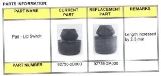

This example is not related to the OP's problem, but illustrative nonetheless. There was originally an issue with the 2009 BH sedans whose hood tamper switch was activated by a rubber stopper mounted on the driver's side of the hood. The stopper was about 2-3mm too short and could fail to "arm" the anti-theft, keeping the system awake, and draining the battery. I got stranded at an airport once late at night because of it. There was a TSB campaign for free replacement to the larger bumper while under original 5/60 warranty.
