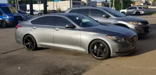

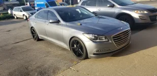

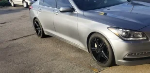

Looking like 20 pounds for the front wheels, 21 for the rears. Keeping the current tires, nankangs with about half the tread life left for now. Plan on replacing the after this summer. So i should be about 58 pounds down also.
Here she is. Haven't really punched it yet, but normal acceleration seems like it take a little less effort.

I mashed the gas for a few seconds and the car is noticeably quicker, i have to say. From about 35 mph to about 70 mph happened really quick. The best way to describe it is that the power hits the ground faster and the car moves more eagerly. However, it doesnt quite feel like the sprint booster or anything like that. Where the car used to accelerate quickly, but steadily, kinda like a train. Now, it just feels lighter, and you feel more of the torque in your seat.
Removing 30 pound of rotating mass at the end of the drivetrain certainly allows for a little more of the engine's torque to be used for moving the car forward, without triggering the limiter
