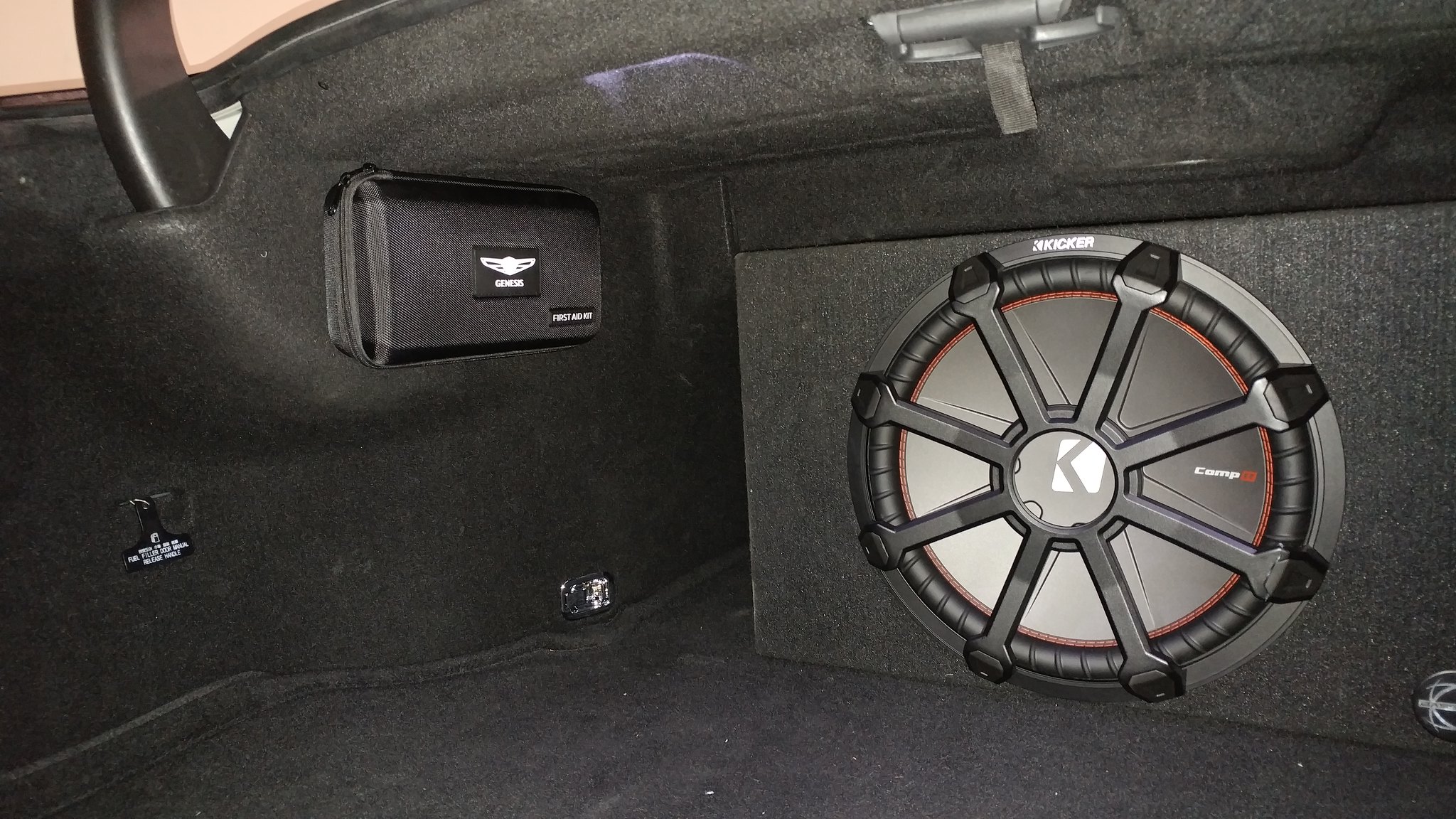

If your sub is still good, you can tap an external amp to power it. That's what I did with mine after installing a pair of subs & amp (all JBL). There is a quick disconnect on the driver side panel that opens up to gain access to the taillight assembly. I disconnected the sub from the factory amp & tied into the JBL amp after needing some room for a road trip. It was a huge improvement over the factory power that was going to it. If the engineers would have dedicated another 150 watts to the sub, it would have blended very good with the rest of the system. The amp that I am using is 1,400 watts (class AB), so, extra care was taken to prevent the amp from feeding the sub too much power.
