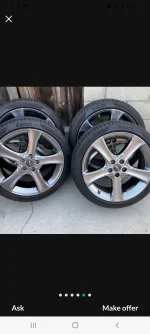

Looking to purchase some 2021 OEM G80 wheels for my 2015 Genesis sedan 5.0. I want to know if this setup will fit on my car. They are 20" wheels with 245/40/20 8.5 square setup with a offset of 43.5. Will this wheel setup fit? Will a offset of 43.5 fit on the front? Please see pics attached.

Just installed them and they fit perfectly. Just needed to make sure I used the correct lug nuts. Fyi.

They are pleasantly clean and nice. I originally had the g80 19 sport wheels on my ride. This is a refreshingly clean new look. The tires are 245/40/20 so my speedo is off by 2 miles and I lost the staggered setup but I like the new look and I can rotate my wheels now. The new genesis oem wheels are nice now so if I can pick them up for a good price with new tires I always replace my wheels with oem.
