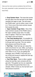

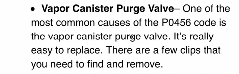

So i have a code P0456 and not sure if anyone out there can give me tips for most likely cause. I dont think this is my gas cap but going to pick one up anyway.
Rest of whats possible but wondering whats MOST likely on a low milage car.
And what is level of effort?
Possible evap hose leak
Possible evap canister
Valves/gaskets
Any useful constructive comments are appreciated.
Fuel cap first. After that continue diagnostic.
If the cap doesn’t fix it, go to a dealer or high end shop with a smoke machine. Any other diagnostic path for a small leak is futile.
