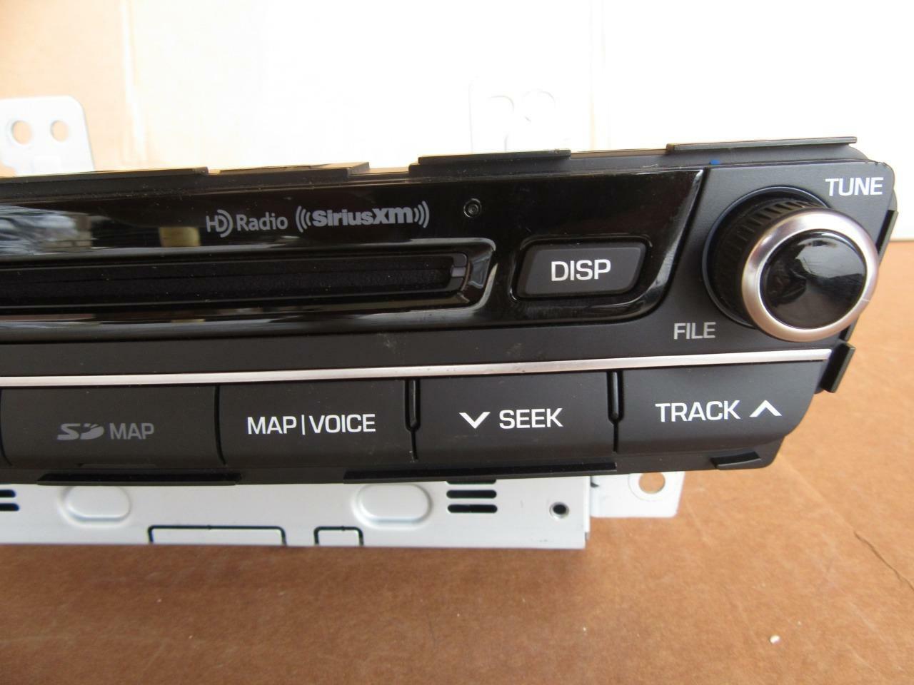

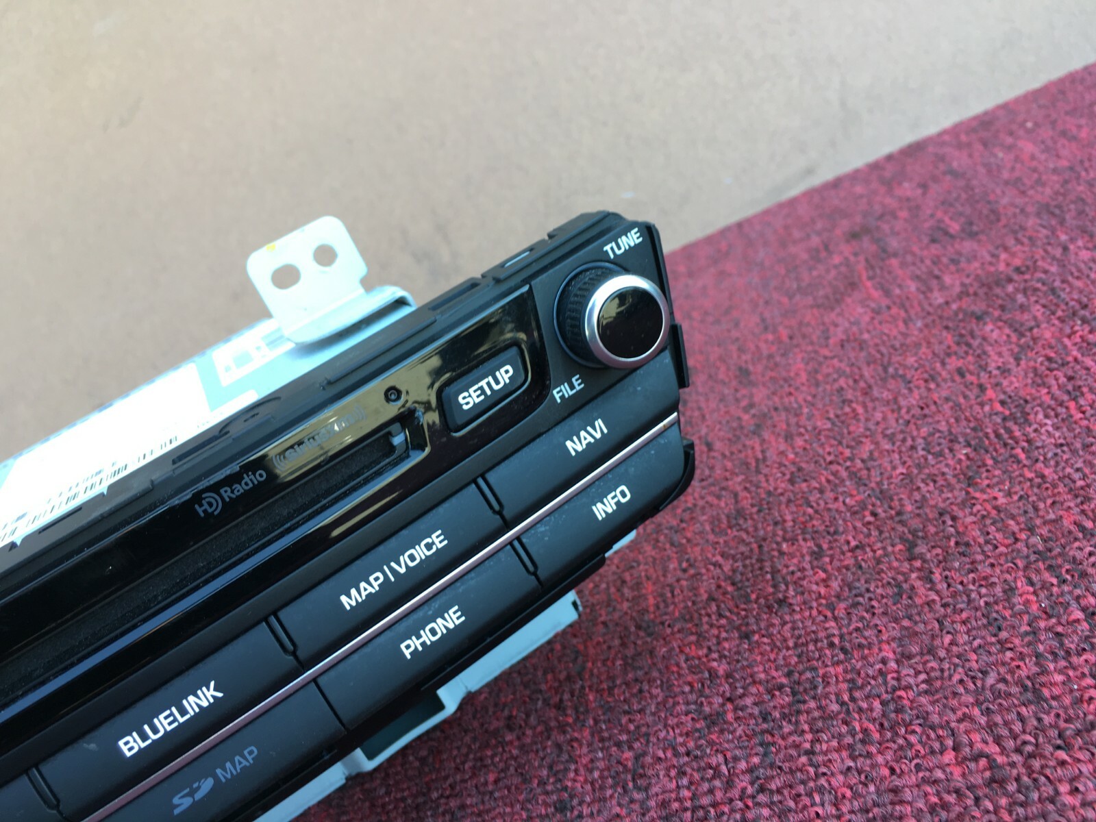

Yeah... they don't say which unit that it is. Jog wheel or Android touch screen only. That'd make a big difference.
Mr. Incredible
SUPPORTING MEMBER
3,158
1,426
Genesis G80 Sport
that appears to be the jog dial unit. as it has the DISP to the right of the CD slot, where the touch only has the SETUP button:
jog dial radio:
Touch Radio:
What you would need to look at to begin with, is whether or not the rear connectors are the same between the 2015-2017 and the 2018-2019 units.
if the connectors are all the same, the next question will be, are the pinouts in the connectors the same, and to know that you would need to get ahold of the service manual and electrical diagrams for the different years in order to compare.
if the pinouts are different, but they both contain the same wiring (just in different places) that is pretty easy to adjust, just move the pins to the correct locations.
if the pinouts are different, i.e. they contain (or don't contain) the same wiring and there is additional (or removed) leads, then likely some type of converter box will be needed in between the car and the radio in order to translate the data in a manner the radio and car can understand. Something like the old "lockpick" devices that where created so that pre 2008 Chryslers could use the >2008 Navigation systems.

this is true..
there are significant differences between the jog dial and touch only (to be expected) looking at the back, the jog dial has extra connectors the touch only doesn't have and the main ones appear to even be a different shape.
but apples to apple the 2015 --> 2018 "should" be the same. the difference as I understand it is the mainboard in the unit, different piece of hardware taking different firmware (windows CE based unit in 2015-2017 and Linux/Android Based in 2018+) .
all things being equal, if all the connectors are the same, the only real difference might be the mainboard and firmware, then there is no reason it shouldn't work.
my concern would be things like the backup sensors, camera, etc. if the other modules on the BUS need something in that old HU that they can't find they may not work, don't really know if Hyundai changed the programming to accommodate the newer HU and different OS.
