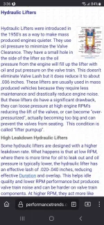

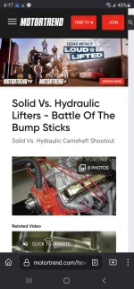

Oh yeah, and if you look at the Motor Trend piece I attached, you will see that Hydraulic was a cheap easy way for manufacturers to make engines quicker and less precise because Hydraulic zero lashes itself and "absorbs" imperfections in valve train, but as you'll read, that's not good ultimately. Just Google the title from screen shot or type in>>
>>"Solid vs. Hydraulic lifters" for tons of articles and real-time dynos with change out of Hydraulic to Solid lifters; Torq and Horsepower gained.

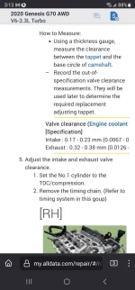

Hey there you are correct on the term "tappet" because they are just like a lifter but "technically" they are being pushed down by the cam lobes directly to the valve stem which is why DOHC, SOHC is so widely used now; much more efficient.
They are shorter, bigger around because the camshaft lobe has to stroke by it, but same principle as a lifter, but no rod under it being pushed upward by the single cam in the middle of the block that moves the rocker arms to push down the valves (open valves with springs closing them).

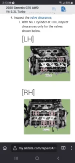

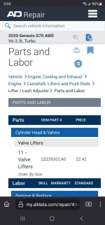

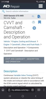

I'm older and am very used to the term lifter and the parts world and even Alldata pro still refers to them as lifters/lash adjusters(last term is correct).

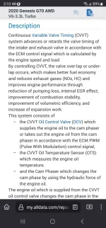

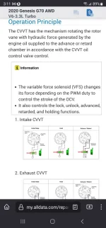

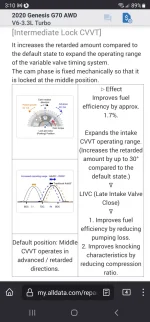

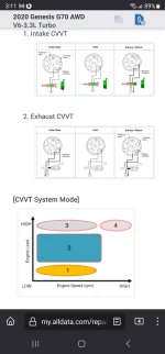

But I did find "tappet" in actual engine work procedures of adjusting valve clearance. Pictures attatched.
Funny they're not getting "tapped" on but pushed down instead of up. "Pushers" 😉👍

The fact that the engine work replacement of these requires the lash has to be adjusted proves they are indeed solid tappets/"lifters"/lash adjusters(pushers).

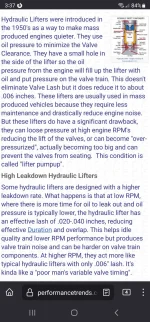

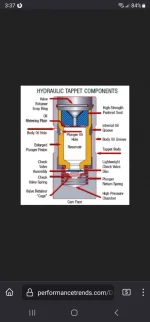

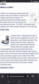

Here's some pictures of truth about hydraulic and solid "lifters"/tappets and a picture of how much stuff is inside an hydraulic lifter. The article even calls the OHC(Over Head Cam) a "lifter", )but picture says tappet). Probably so that the regular person doesn't get confused with terms they've never even heard of; that's my guess. The article talks about hydraulic "lifters" starting in 1950's. So the term lifter has been around since most of us were born. Tappets came around maybe last two decades. Ford started there Muatang overhead cam, SOHC in the late 90's, 4.6L. Mustang guys hated that they got rid of the 5.0 badging, and that "modular motor" wasn't great.
