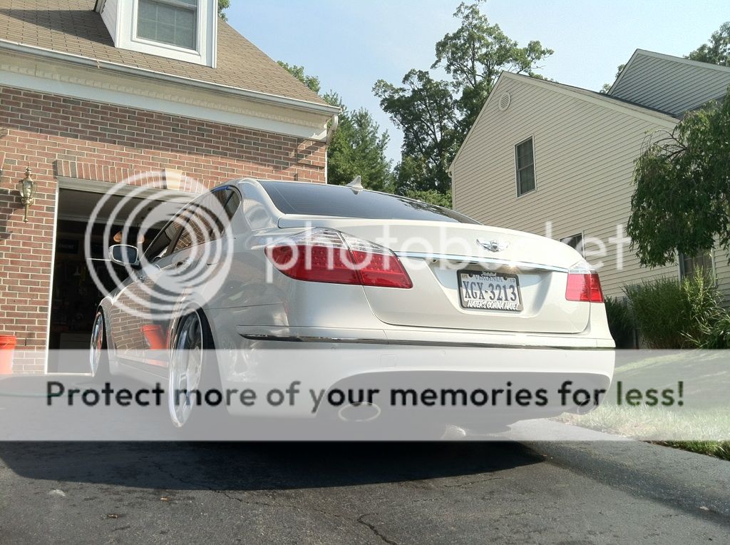

so how flush are you sitting with the rear with the offset? got an pics?

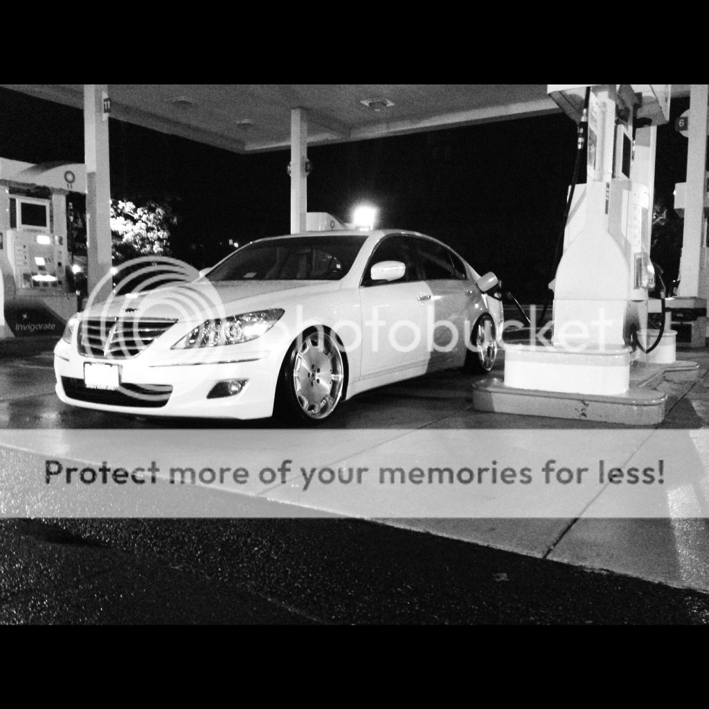

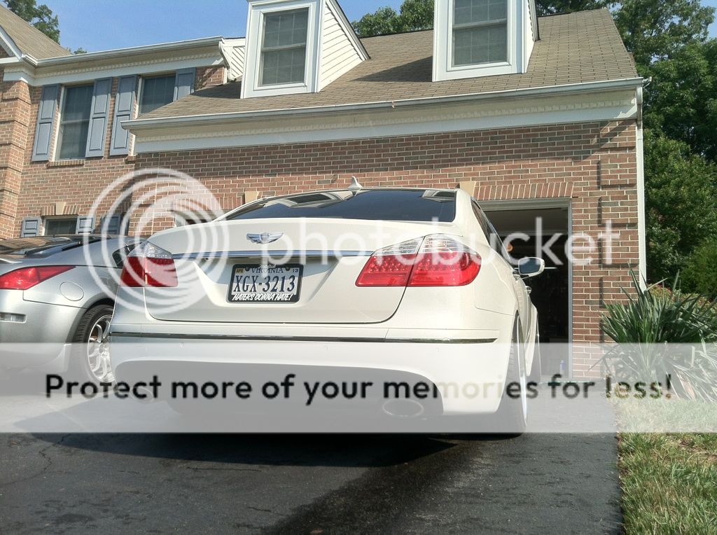

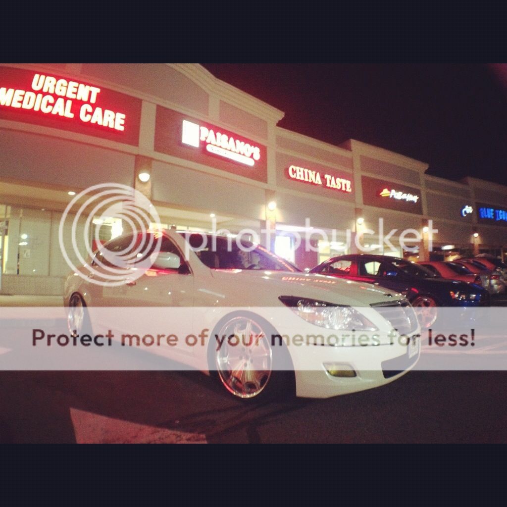

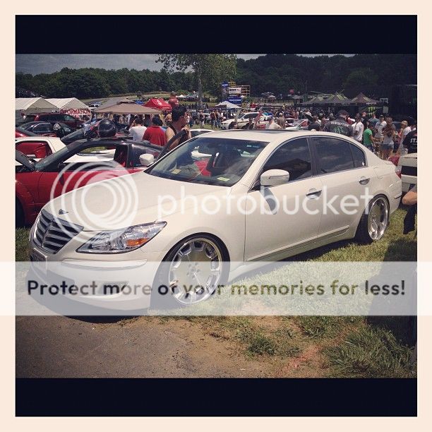

I do have a picture thread here in this forum. But here are some pics. This isn't for everyone and I understand that, but it's the VIP Style look I'm going for.
camber is maxed out in the rear at like -3 or -4... Something like that.

What wheels are those? I think I might like them ha
