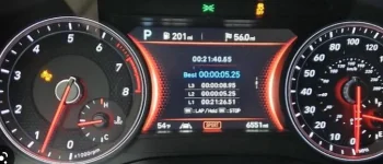

^ what i'm talking about looks pretty much like this:
you access this by using the steering wheel mounted button for menu selection. i would expect all trims to have this. but i can't say that for sure. mine is a 2.0T, 6MT Sport trim.

^ weird. dunno why Genny would drop that simple menu feature from some trims - they have turbos too! the menu also has the lap timer and g-force screens. maybe one more.
that pic wasn't my actual car, that must be a slushbox Sport trim (hence the "P"), but otherwise it is identical to the '19 gauge package. also, i never drive in Comfort mode...never. either Sport for spirited drives or Eco for stop and go commutes since it smooths out driveline lash.
