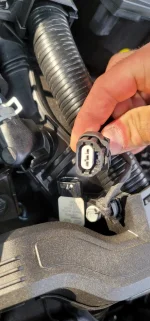

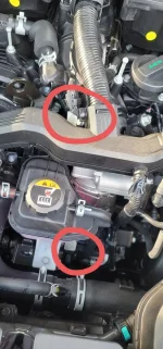

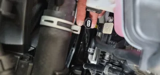

So we have found the the 3 pin connections.
Burger will have to come out with a CANbus Firmware update in future. But he tells me that it should get about 50hp gain without the CANbus update and about 80hp gain when the CANbus update is available.
Should be (2) 3 pin connectors as per Burger
