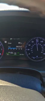

Hello,
I have a 2015 Hyundai Genesis H-track. It has 78k miles on it now. Great car. I've had some work done on camshaft sensors and wiring in part due to rodents. This lady time I took it in they had to take the intake manifold off to fix wires and remove debris. Right after picking it up my gas mileage has decreased 4-6mpg. I've filled up a couple times driven city mostly and then hwy and can barely average 20. Now I know the MPG says that's about right. But, I have proof that I've gotten around 24 doing some city driving and mostly highway. I also have proof that I've gotten 28mpg hwy. What's going on? Any thoughts?
Additionally, I noticed more exhaust coming from my left tailpipe than the right. It is already getting cold here and noticed the difference compared to earlier this year. Or at least I think. Is it common for more exhaust come from one side than the other?
