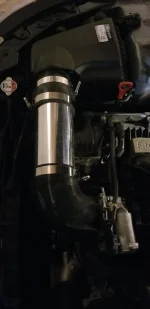

2015 3.8 AWD w/ AEM cold air intake.

In this case I was fabbing it up for the BH model. It does seem that the DH set up is very similar though

I was going to ask if you could modify the DH one for BH.

Honestly hard to say possibly. As for the actual intake it's very similar bends and fitment however the DH looks like it has an extra vaccum hose port compared to the BH injen one I have that only has 1 port
