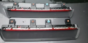

3rd brake light trim molding hanging
This is a common if minor issue. Losing this bit of rubber means that your back seats get bathed in a warm red glow when you’re backing up at night.

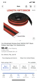

Weatherstripping works well as a replacement part and it’s a lot cheaper than the Hyundai part.
What kind o weatherstrippind do you use
Just some fairly thick black stuff. It was at least 1/4" thick. You can barely tell it's there.
