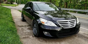

Frogg, Did your setup of 18x9.5+30 work? Can you post photos? I want to do the same setup but it's hard to sift through different posts for correct information at times.
Only photo I have on hand at the moment but I'm running 18x9.5 +25 with 255/45R18 all around on BC coilovers. Rubs a little on big bumps but also have the V6 kit, upgrading to the stiffer V8 spec springs soon. Ran these last year at stock height without any issue.Snapchat-1765184603.webp
