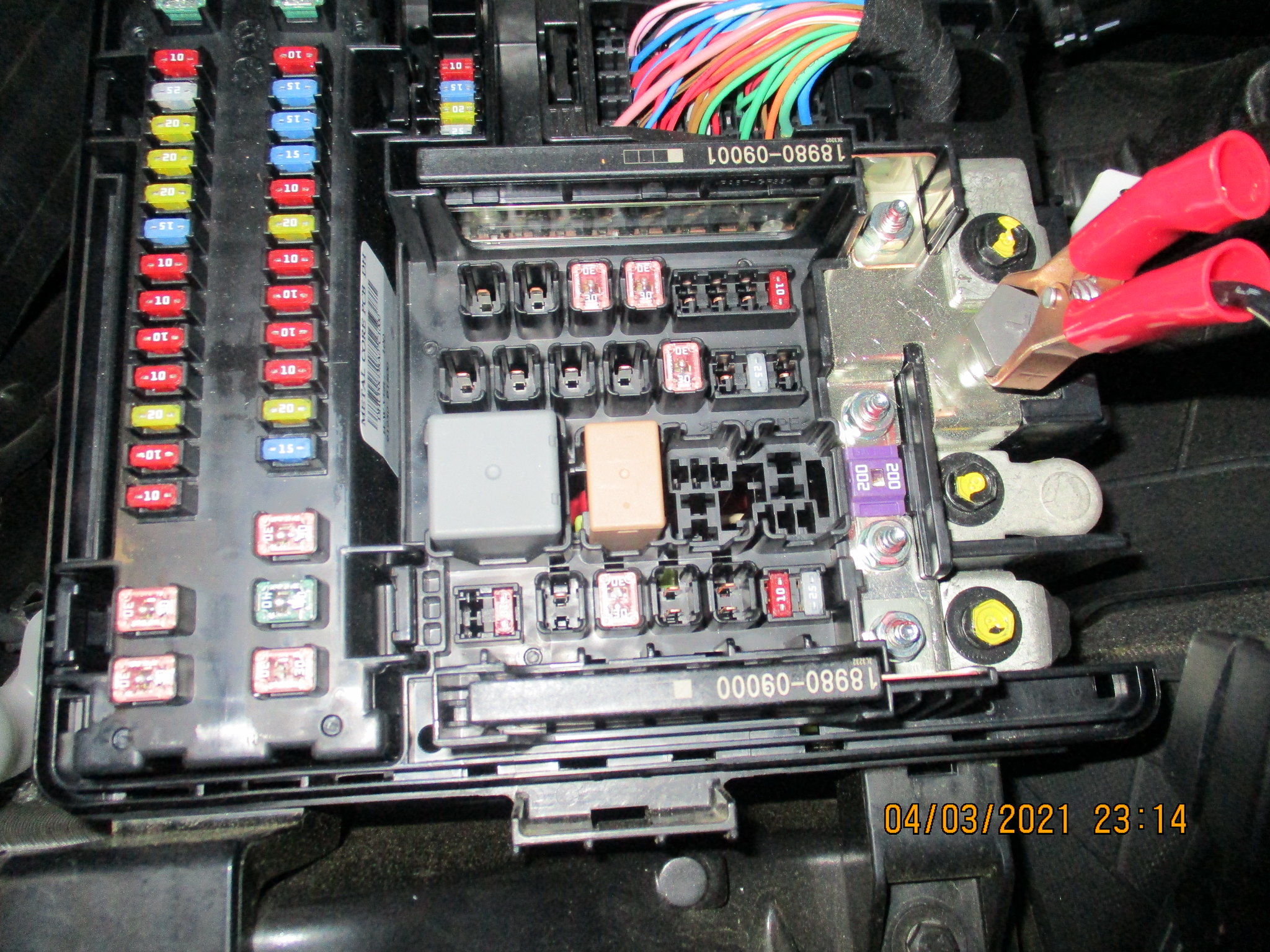

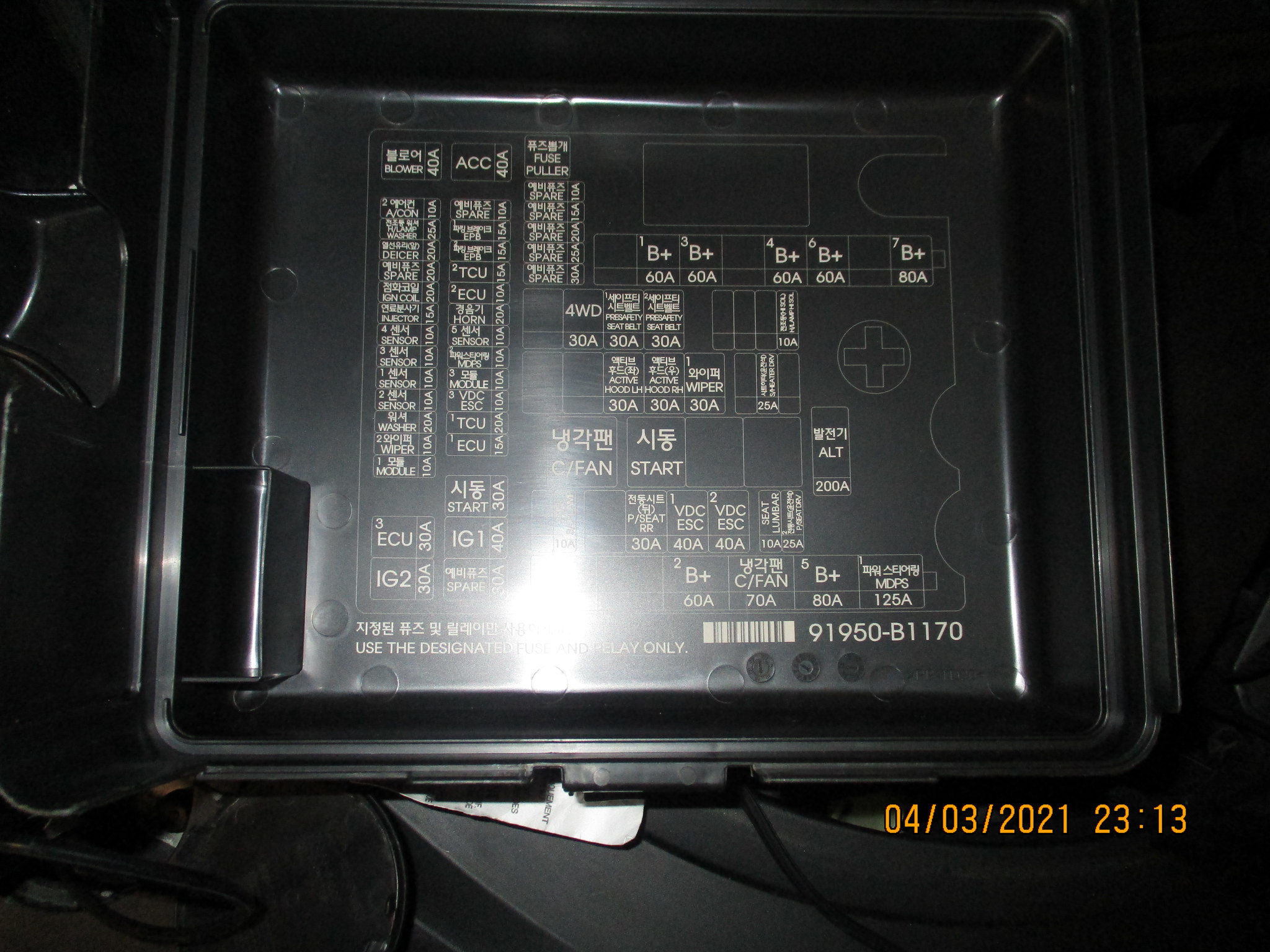

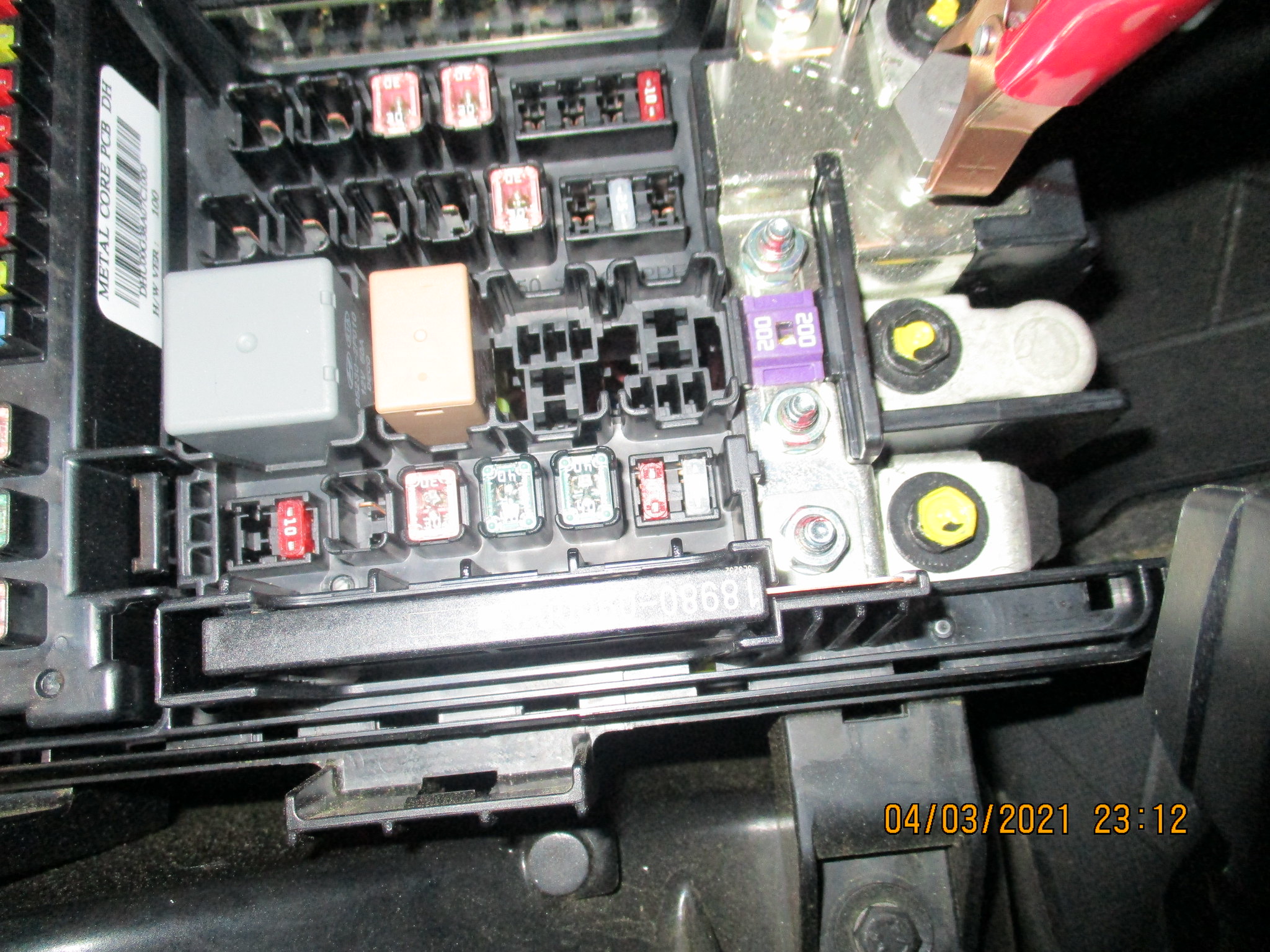

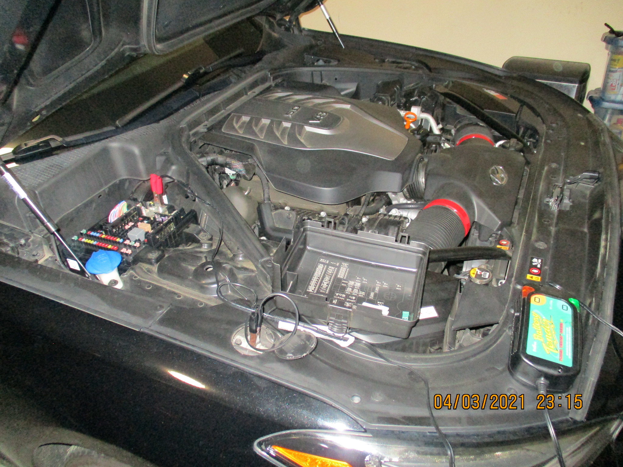

The fuses are located in the fuse box in the engine compartment. I believe the 40A fuses in question are labeled VDC/ESC which controls ABS. The fix for other Hyundai cars with the ABS recall equipped with 40A delay fuses are 25A fuses delay I believe, however I am not certain what the Genesis will receive.
Here is what I do when my car is parked in my garage. I pull out the two 40A fuses until I drive my car and then I reinstall the fuses. Pretty easy to do; so I will do this until Hyundai sort the issue out or make known the new fuse size.
The two bottom green 40A fuses is what I remove labeled VDC/ESC.
