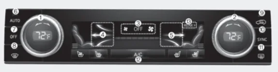

Seems like same happened to me before. Try leaving the HVAC (#7) on but just turn off the A/C button (#12). That seems to let the temperature and vent selection functioning automatically.
Good info. I think whatever temp is set at the time the HVAC is turned off, keeps the blend doors in a position to best meet that demand. For me, I had it set at a temp where it probably wanted to add in some heat from the heater core. So the air was traveling in from outside, though the passages, and the blend door was in such a way that it forced some or all of that air over the heater core.
