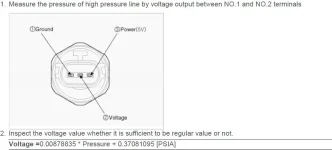

5) Disconnected the wire from the HI pressure sensor. It is 3 pins sensor (+5V, Ground and Voltage Signal).
Computer supplies 5V and GRD and measures the the voltage at Voltage Signal that changes according the pressure.
Measured on the sensor a shortcut between GRN and the Voltage Signal while the cable is disconnected.
According the formula in the attached print screen, it is impossible to have 0V at Voltage Signal. The minimum will be 370mV. I think then it is 0V, this is a way to ECU to know that there is some disconnection occurred. But then I would expect to some error.
I think, as the system is still under the pressure, it shouldn't shows this even though there is no 5V to the sensor.
First question: Is it enough to determinate that sensor is faulty? A new sensor is not so expensive, but I gave to bleed and to refill the whole AC system(((
