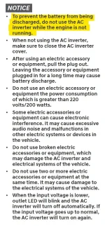

Apart from this minimal info in the manual, I cant find any details. Am sure one should use the AC outlet only when car is running, and not for a hair dryer!!
But is it reasonable to use it for a hot water kettle? What does anyone even use it for? TIA

You would need to know how many watts the inverter is rated for to know what it would run. I see no reason to only use it with the engine running unless you are using if for a long time. Again calculate the usage.
Am sure one should use the AC outlet only when car is running.
These are warnings in the GV70 owners manual.

You would need to know how many watts the inverter is rated for ...
The snap shot above from the owner's manual clearly says 150 watts.
I may be wrong, but I think I say it printed on the outlet somewhere.
Basically, no motors or heating or cooling devices. Good for a lamp and such.
I'm not surprised. Inductive loads are a big problem for inverters, and they probably didn't put the money into handling that. (I'm not meaning that in a negative way. Most people probably don't want to pay for something they won't be using anyway.) The warnings against heating devices may be for other safety reasons too.
