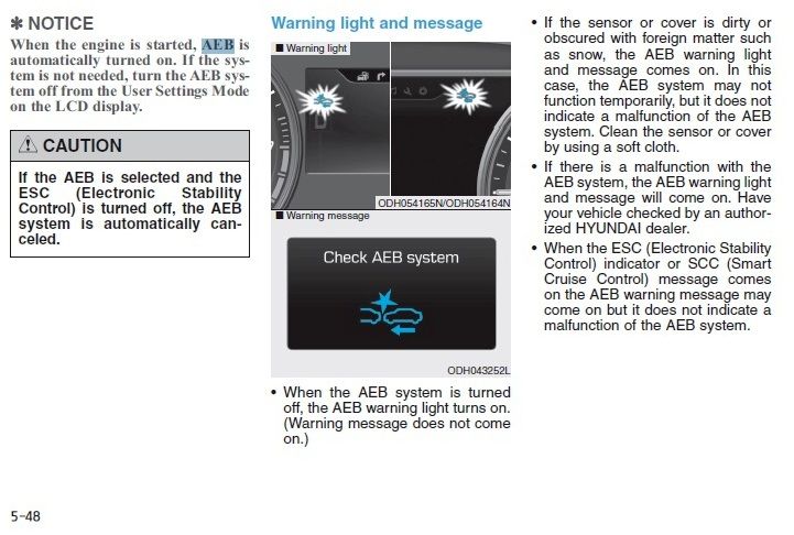

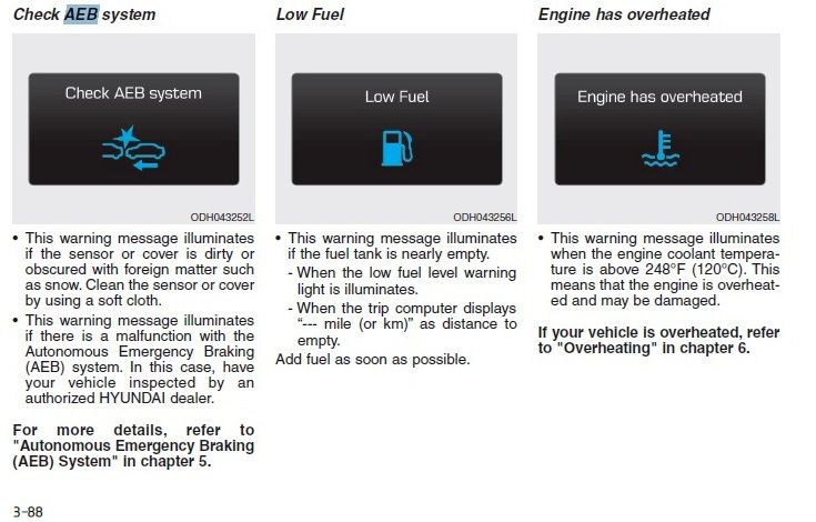

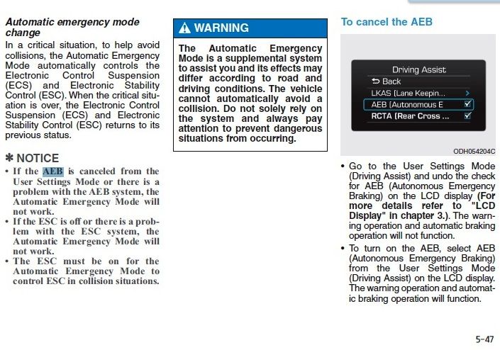

As stated in another post by another poster, the AEB system on any manufacture (BMW, Jaguar, MB etc...) does not work when covered in snow. This is also stated in Genesis manual. See below. You can also deactivate it which is what I recommend in those conditions so you don't continue to get the error message. The good part about this is that every time you re-start the car it will be activated so you won't forget to turn it back on later when the conditions have improved. I posted how to turn it off below as well. Hope this helps you.
Warnings from the manual:
How to turn it off from the manual:

Just like the frost covering your windshield in the morning allows you not to see out it also must see to function. Cake it with snow/dirt or mud and there is no way it will work. It's not voodoo you know. :rolleyes:

Isn't there a way to turn it off in car settings or a function button on dash? I have the same system in my Mercedes and there is a way to turn it off in it. My 2011 Genesis does not have it so I am not one to know about the 2015.
Two posts up - manual reference from our resident forum car manual searcher, Alwaysforward ;)
I know that there is a method to turn it off... W
The issue is it defaults ON after turning the car off. AND, even if you turn it off, it will still issue a malfunction warning. So you have to drive with a yellow triangle with a exclamation point by your gauges... That's just annoying in my opinion.
