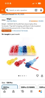

I used a newer kind of wire tap so no factory cables were harmed in this install:).
“Quick splice wire terminal” on Amazon, less than $10.IMG_4365.webpIMG_4364.webpIMG_4371.webpIMG_4370.webpIMG_4369.webpIMG_4368.webpIMG_4367.webpIMG_4373.webpIMG_4372.webp
