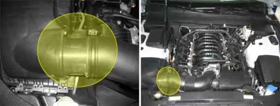

I'm not 100% sure what you're looking at is a filter. I know there is a secondary filter in between the air box and the throttle, but there are also a few components that are described below. I'm not an engineer, but common sense dictates that if you change flow rates the computer is going to react, whether it's good or bad is indeterminable.
This is from the HMA website.
General Information'>GENESIS(BH) >2009 > G 4.6 DOHC > Engine > Engine Control > P0101 Mass or Volume Air Flow \'A\' Circuit Range / Performance > General Information
The Mass Air Flow Sensor (MAFS) is located between the air cleaner assembly and the throttle body. The MAFS uses a hot film type sensing element to measure the mass of intake air entering the engine. This hot film type air flow sensor consists of a hot film sensor, housing and metering ducts. Mass air flow rate is measured by detection of heat transfer from a hot film probe. The change in air flow rate causes change in the amount of heat being transferred from the hot film probe surface to the air. A large amount of intake air represents acceleration or high load conditions while a small amount of intake air represents deceleration or idle. The mass of intake air should increase at acceleration and be stable during constant engine speed. The ECM uses this information to determine the injection duration and ignition timing for the desired air/fuel ratio.

I know what a mass air meter is and how it works. Mass air equipped engines will adapt for increase air flow. Ford MAS would accept a 15% increase air flow before maxing out the flow table in the ECU. I am going to assume the Hyundai MAS will accept a simular air flow increase. Air flow is usually restricted by the diameter of the smallest opening in the intake (throttle body) air box system (MAS). I was not looking for discussion of MAS, I just wanted to know if anyone had removed the upper filter in the air box?
