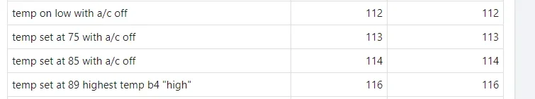

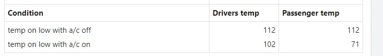

Thanks for all your help air540g. This time the duel button was on and the recirculate was on, but stilll some strange readings. Do you think it's a blend door or ?
Temp in garage 92 degrees​
All temp readings are with the engine at idle​
Fan on full speed​
Duel mode on​
recirculate on​
Condition
Drivers temp
Passenger temp
temp on low with a/c off​
112​
112​
temp set at 75 with a/c off​
113​
113​
temp set at 85 with a/c off​
114​
114​
temp set at 89 highest temp b4 "high"​
116​
116​
temp set at high with a/c off​
153​
180​
temp on low with a/c on​
102​
71​

I think the temperature door and the actuator are good. You can ignore the max temp because it is useless. You need to replace the actuator if you want to get the same temp on max
I think you need to refill R134A. Because the only difference is "ac on". Ignore the actuator and refill the R134a is the cheapest way.
