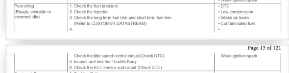

As to troubleshooting your stalling/rough idle in gear, from the manual (ref: https://cardiagn.com/2012-14-hyundai-genesis-fuel-system-3-8l/ ):
ECT = engine coolant temperature
EDIT: the emission control section of that same 2012 3.8L manual suggests that there is a MAF combined with the IAT downstream of the throttle body, so unless the manual is wrong it might be using the same code for that sensor whether or not it has an actual MAF? Sorry I'm not a 3.8L guy. Ref: https://cardiagn.com/2012-14-hyundai-genesis-emission-control-system-3-8l/

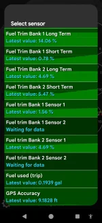

Yikes!! Looks like both my downstream sensors aren't cranking out any data. I may try replacing them, but I have a bad feeling this is CAT issues. I use the car on a 100-mile commute daily, and I drive it pretty hard.

High fuel trims suggest an air leak (O2 sensors are getting too much oxygen, which the ECU thinks is running to lean, so it adds fuel). This is consistent with poor idle performance. This condition, if left unfixed, will cause to accelerated wear-out of of the cats among other issues. Time to go see the mechanic.
