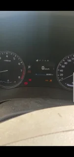

I am having an issue with my genesis 2015 car , it appears all warning light on, the gear shaft not working as usual , camera not working all the time , AC not cooling but the fan and more .....
I went to workshop and couldn't detect the problem by using the computer , can't connect .
I have seen similar issue with someone called John Squires in this forum was Feb 6 2018, but I am not sure what he did to solve it.Screenshot_20190922-001525_WhatsApp.webp
You have a CANbus fault. Most likely a failed module. If connection is failing, what is failing?

I have seen similar issue with someone called John Squires in this forum was Feb 6 2018, but I am not sure what he did to solve it.View attachment 23423
