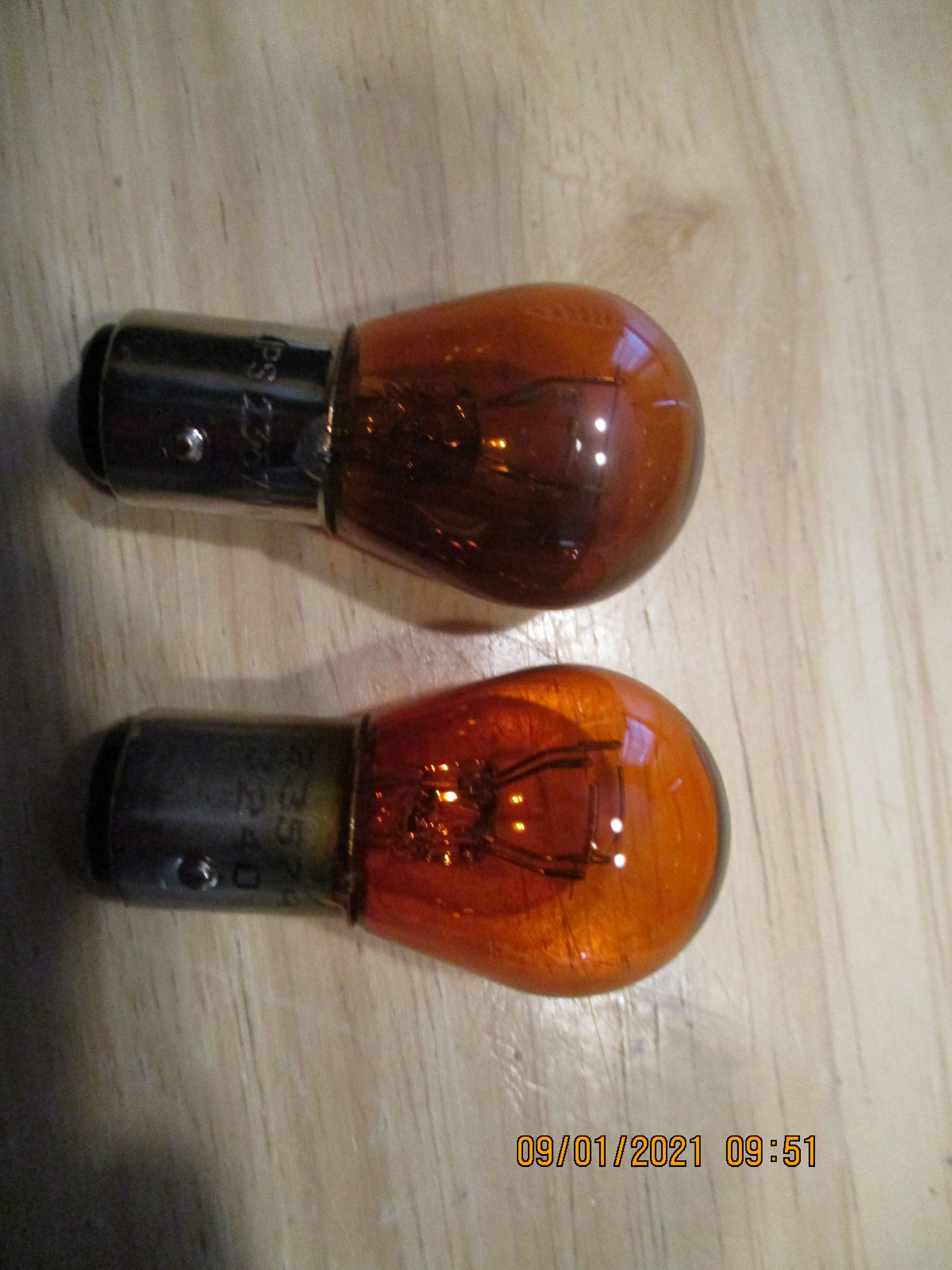

Here is a picture of the two bulb types during my last bulb change. The Phillips 2357NALL on the top after three years of use. The new Sylvania 2357ALL on the bottom. Only the driver's side 2357NALL bulb lower filament failed, the passenger's side 2357NALL bulb in the picture was still good after three years of use.
The 2357NALL is a darker amber color, but the lighter amber colored 2357ALL is brighter during use. Time will tell if the 2357ALL coating will flake off like you described.
