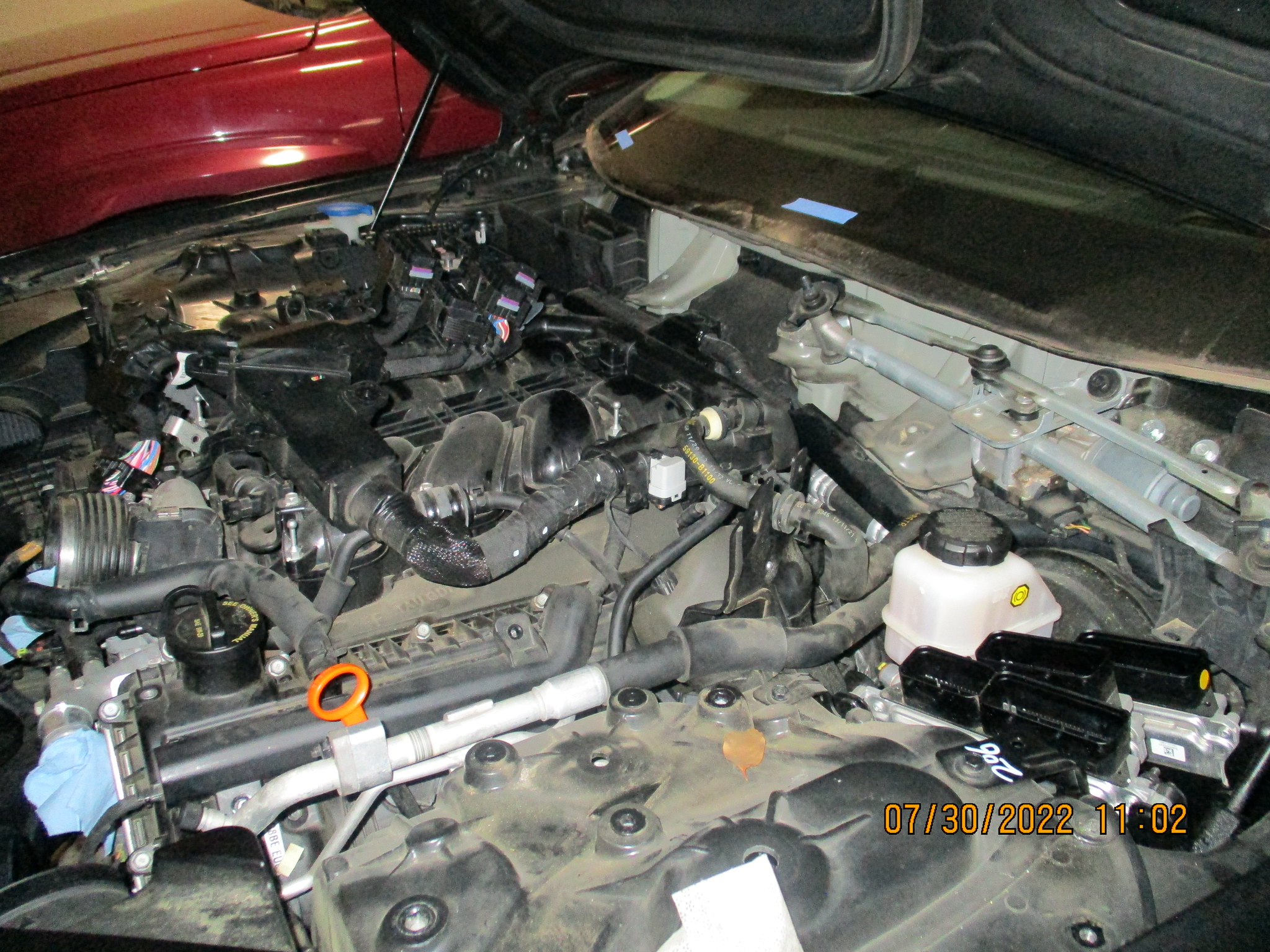

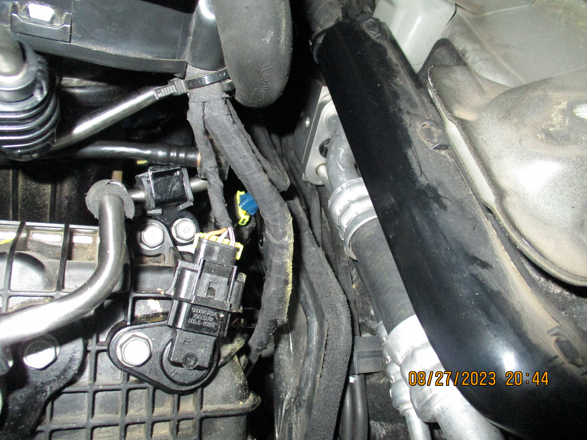

You can reach the crank senor from the top of the engine if you remove the wiper cowl trim and firewall trim. you may have to unbolt the wiring harness cover and disconnect the cam sensors on the valve covers to have better access to crank sensor.
Not the best pictures of the crank sensor, but you will have more room to access the crank sensor with wiper and firewall cowl removed.
