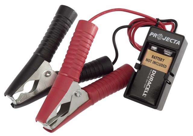

With any car which is heavily battery dependent make sure to use this little Memory Saver gadget before disconnecting the car battery. I placed one of these next to the car battery with a note saying:
Before disconnecting car battery please install this Memory Saver :
1) Install the 9V battery which is enclosed
2) Connect red clamp to red car battery lead FIRST
3) Connect black clamp to black car battery lead
4) Remove car battery leads from battery and make sure Memory Saver clamps stay in place
I have attached this note to the Memory Saver so that anybody needing to remove the car battery while I am not present knows what to do. I disconnect the 9V battery from the Memory Saver simply to safeguard it from slowly draining. If it is not used for many years it may be prudent to replace the battery from time to time or at least check the voltage. It is no good to find the juice is gone when you actually need to use it.
