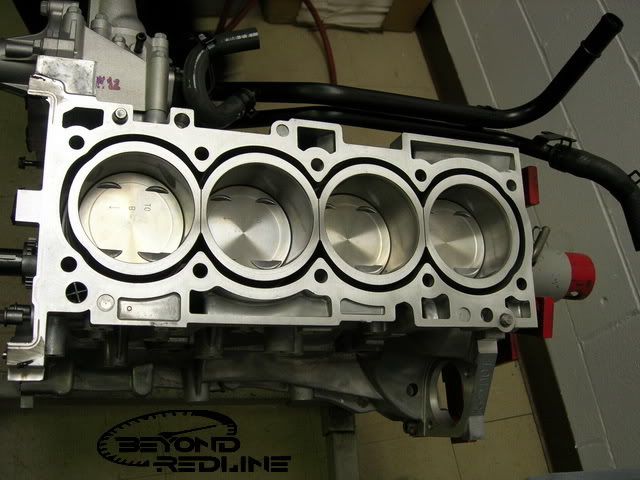

It is indeed an open deck design. That SUCKS

The difference between the two decks is that theoretically, a semi-closed deck block is capable of handling more boost due to the extra structural ribbing on the cylinder walls, where as an open deck block does not have the extra ribbing and theoretically can handle less boost. A good example of this is the EJ205 block of the 02 - 05 WRX's when compared to the EJ257 or EJ255 blocks on the current turbo Subaru's.
Open deck engine : Easiest to cast also cheapest. Which is why this is put in Genesis Coupe...There is big empty water passage between cylinder wall and block, and thus theoretically unable to hold extreme cylinder pressure at high boost applications.

Semi-closed deck engine : different casting method, more expensive and harder to cast than open deck. More cylinder wall rigidity than open deck but still,,its no closed deck.

EvoX 4b11t - semi-closed deck aluminum block

Closed-deck design : different casting method which requires more material and time. All of the engines which produce gobs of hp/displacement are closed-deck.

Rb26dett is also closed deck iron block. e46 m3 engine is closed deck and e92m3 engine is closed deck aluminum block.
Iron sleeving could strengthen the cylinder wall and some say lots of people have been making good power with open deck engines. But displacement to displacement, open deck design will NEVER make same power output as closed deck design, much less aluminum block as opposed to iron block.
just look at supra block which makes 800whp safely on stock bottom.
Evo's 2 liter makes 1000+whp when built.
So not only internals are cast on genesis coupe, the block design is open deck. I guess we'll see how much power this can hold up.

You have EJ257...unless you got a wrx block in your Sti.
semi-closed deck aluminum block.
