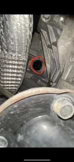

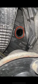

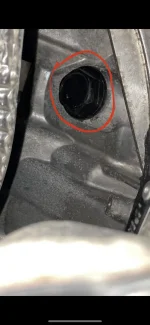

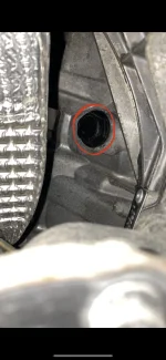

Anyone have any idea what this 27mm bolt/ plug is?
2015genesisNewbie
71
12
Temple, TX
Just curious. Driver side, back of the engine, under the exhaust manifold. 2015 Hyundai Genesis Sedan 5.0L V8

carguy75
1,488
736
Atlanta, Georgia
Best guess off the top of my head says that it could be a drain bolt for draining the engine coolant out of the engine block.

Nailed it.:)
Drain bolt it is. #6 on the diagram. However, not sure if it for oil or coolant. Usually it is for coolant.
I’ll take it
Nailed it.:)
I figured it was some sort of drain plug but for what I didn’t know. Thought about oil but didn’t see the point. Didn’t even think about coolant so that makes more sense. I came across it looking to see if there was some sort of access port to drain the torque converter. Wanted to do a transmission fluid drain and fill without doing a flush but get more fluid out than just a pan drop. I did a pan drop drain and fill and used Amsoil with the SP-IV-RR rating... HUGE EFFING MISTAKE. Transmission has NEVER been the same 🤬🤦🏻‍♂️ want to replace ALL transmission fluid back with Hyundai OEM trans fluid but honestly at this point I don’t think it will make a difference. Feels normal when I floor it and at high speeds hard acceleration etc. but at low speeds when I baby it, you can tell something isn’t right. Stutters like it’s not sure what to do. LESSON LEARNED.
