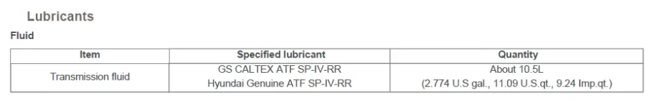

Pulled one out of the owner's manual and the other out of the service manual.
