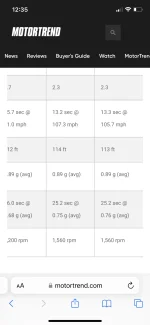

While I can’t provide an answer of my own. See the link for the results of testing performed by Motortend. AWD had slighter higher g rating for the figure 8 test but probably not real world noticeable since it still had the same time. I think the figure 8 and lateral acceleration testing is what you’re looking for.
And the 45mph passing time was the same which I was curious about. So the weight and drivetrain doesn't effect speed while rolling, weirdly enough a slower 0-60 which is where the AWD should shine typically, probably from the added weight.
