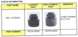

Here's the location of the rubber stopper that engages the hood alarm switch. The correct replacement part is the larger of the two(92736-3A000). If your rubber stopper is still there, see your dealer for the larger one (cost is <$10).
