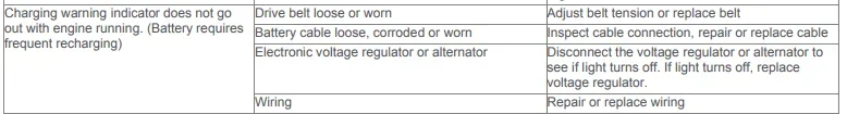

I changed battery and alternator and light on dashboard still comes on after 15 minutes or so. Do anyone no why or have any suggestions
The light indicates a charging system fault. This is rarely the battery. While is it most often the alternator, sometimes it is not. Have you done any diagnostics? It will be expensive to keep throwing parts at it.
So far I just changed battery and alternator!
Also check: Alternator belt tension, fuse block on top of the battery, wiring, grounds.
