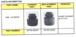

Next time you park the car at home, watch the CD/DVD slot for about 20 minutes after parking. The blue light at the top/center of the slot flashes a few times when the entertainment system switches from STANDBY to full OFF modes. If you don't see this flash within half an hour, your nav/entertainment system is staying in STANDBY which is a larger amperage draw. Why would it stay in standby you ask? The system does not fully shut down immediately - that way it can "wake up" more quickly if you return to the vehicle in a short time. Stopping at Starbucks or something... But it you don't return within that 20 to 30 minute window the car assumes "we really are going to stay parked for a while" and fully shuts down. Any open door, trunk lid, or open hood keeps the system in STANDBY regardless of that 20-30 minutes time: if everything is not fully closed then you "have not left" as far as the car is concerned. This also prevents the theft alarm system from arming. A common problem early on was a rubber bumper on the underside of the hood was missing or not big enough to actually press the button below it so the car thought "hood is open" all the time. There is a TSB about it: TSB number 09-BE-026. With the hood open, look on the driver side edge about half way between the front and back (windshield end) of the hood for a rubber bumper. If it's damaged or missing that is your bug. In the black plastic stuff surrounding the engine you'll see the switch this bumper is supposed to actuate. Make sure it hasn't become dislodged. Use the multimeter to test its operation too. The TSB replaces the rubber bumper with one that is a bit taller to make sure it presses the switch.
Note: there are other rubber bumpers in corners of the hood... ignore them. If your hood does not sit level with the fenders when closed these bumpers may be "unscrewed" too far; try twisting them in a bit. If they're holding the hood upwards too much the hood-closed bumper can't reach the switch to do its job.

I just looked at the CD, since the car has been sitting for about six hours now. No light. Then I hit the lock button on the remote and it locked. I unlocked it and popped the hood. Did not lock correctly until I then dropped the hood again. I found the TSB and it covers my car. I'll still check it out tomorrow.
Our cars should be less than 20mA when asleep. At 20mA a battery will drain from full to dead in about 4 weeks. One common culprit is the security system. Normally you get a beep+flash when system arms properly (entrances are closed and fob lock button pressed). If the system does not arm properly, it stays awake and draws high current (100mA or so) and will completely drain a battery in a few days. Missing/damaged/wrong-size rubber bumper on the hood is the usual suspect, there was a TSB way back when to swap for the larger part#.
