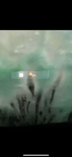

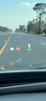

Black circle covers half my heads-up display
Keishat8
Nov 29, 2022
4
2017
Genesis G90
My Heads Up Display developed a blank circle in the middle.. The only way it moves is I enter a destination into navigation. Then it goes away. When I turn it off it’s still hidden. Anybody got a solution. Pictures below. I was in a car wash lol

I am not familiar with issues from the HUD. Have you checked it to see if there's anything that maybe is sitting on the screen?
2017 G90 Ultimate
67,025
Looks like the LCD for the HUD has developed a bad spot. It seems like it is caused by heat radiation from the sun, but I'm not certain about that. We've seen temporary damage on some of our LCD from this, and we have some with permanent damage that we think was caused this way.
One day I was apparently at just the right angle for the sun to start blacking out my HUD. Fortunately, after a mile or so the road turned and the HUD slowly recovered.
It's humidity condensing on the plastic, it'll go away
