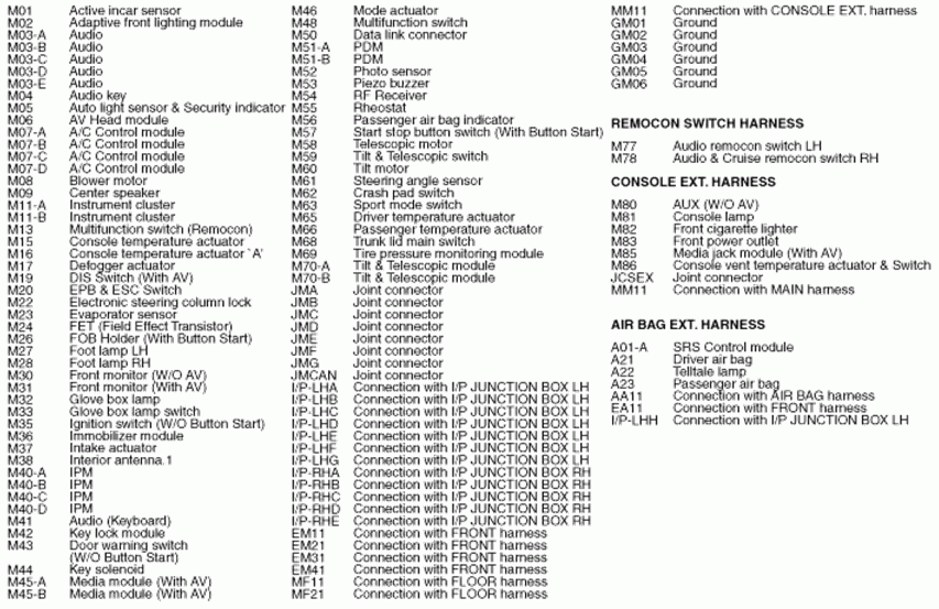

May be a silly question . where is the blend door actuator located ? I have a 09' sedan 4.6 and my A/C is blowing hot on one side
2009 Hyundai Genesis 4.6 V8 - 4.6L 4627cc GAS MFI Vin F - 4 Valve DOHC
HVAC Components
A/C Control Module, Field Effect Transistor, M07-A, M07-B, M07-C, M24, M66, Passenger Temperature Actuator
Body Components
Instrument Panel Components
Console Temperature Actuator, Driver Temperature Actuator, M15, M16, M46, M65, Mode Actuator
Body Components
Much appreciated !!
